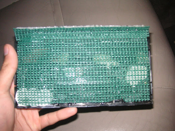

Fake Faceplate I made a fake faceplate for my double din touchscreen. I saw someone else do it so I decided to give it a shot. Its very easy and just requires some hot glue and a precision screwdriver.
1) Remove the factory stereo from the LC.
2) Remove the power/volume button from the stereo.
3) "Pop" the front faceplate off, there are little tabs all around it.
4) Remove the little screws on the back of the now removed faceplate. Some of them are shown in red.
5) Now you can separate the circuit board from the faceplate.
6) After you separate the circuit board and faceplate you'll need to glue the buttons back on. (they fall off once the circuit board is separated from the faceplate). I used that fast epoxy stuff but hot glue would have been better.
7) Buy some of that sticky place mat stuff (I don't know what it is called). Its found near the plates and place mats at Walmart, it comes in a roll in many different color. I chose green, you probably should choose black. Use the glue and stick some of that place mat stuff on the back of the faceplate. It will prevent scratches to your screen and help it to stay on.
8) From the front it looks great
9) From the side not so great. Honestly at night it looks fine, especially if you do not know what you are looking for and are looking into a muddy truck.
I realize that anyone could have figured this out and that this thread may seem like an overkill for something that is easy but I thought it would be helpful anyways.
